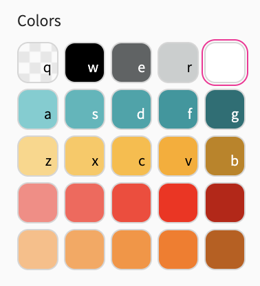

The palette in the file above looks like this:
The colors in the first row of the palette are automatically generated. The two grays are tinted based on the middle color of the first first row of your palette: “d” in the screenshot above.

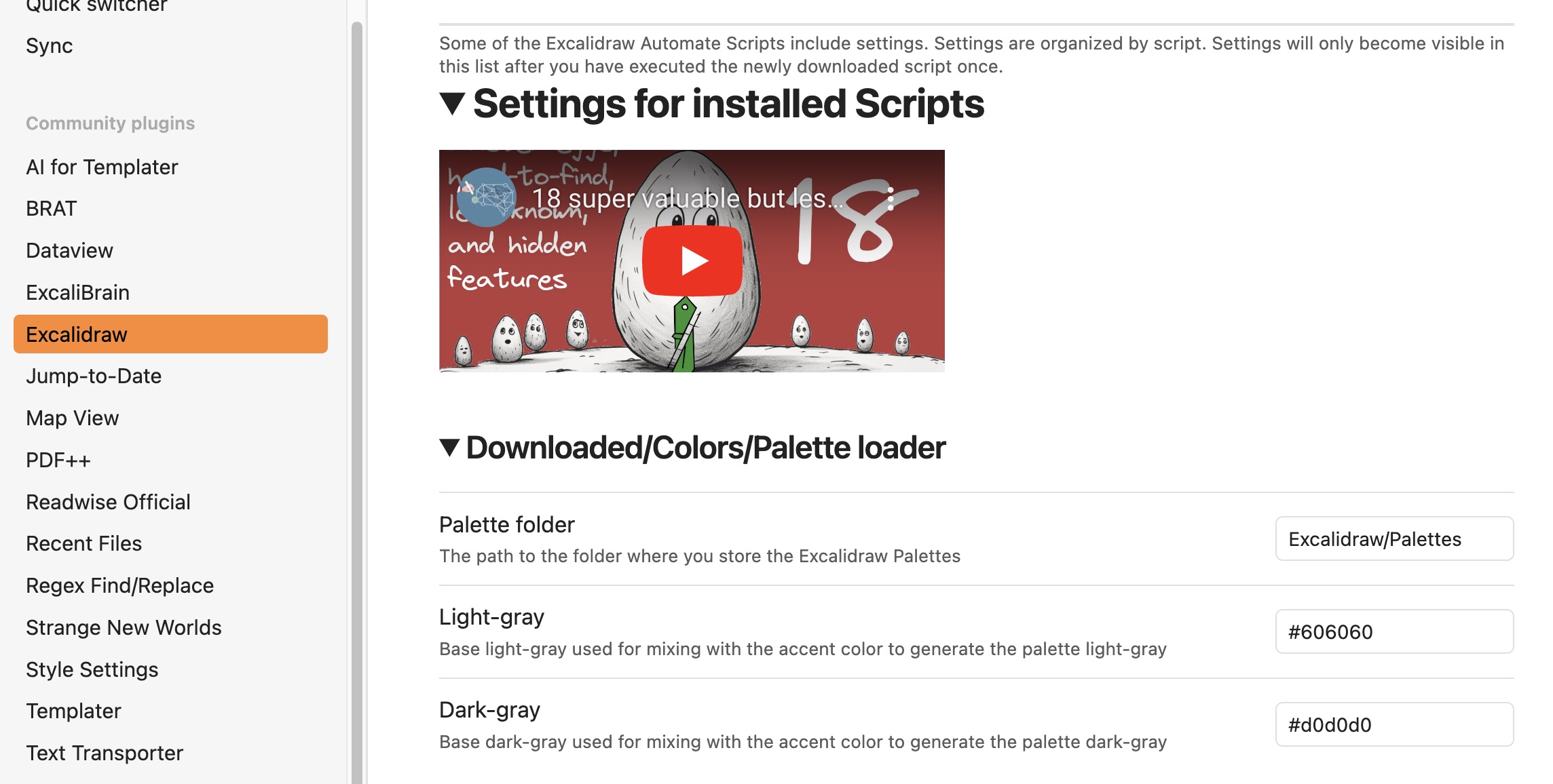

The palette file is a simple markdown file placed in the Palettes Folder. By Default it is the Excalidraw/Palettes folder. After downloading the [[Palette Loader Script]] you need to run it from Obsidian Command Palette. At the first run, the script will register a custom settings section at the bottom of Excalidraw Plugin Settings. You may configure the palette folder here. Note, that foler names are CasE seNSitIVe. You may also define the light and dark gray values used by the script to create the tinted grays in the palette as mentioned above.

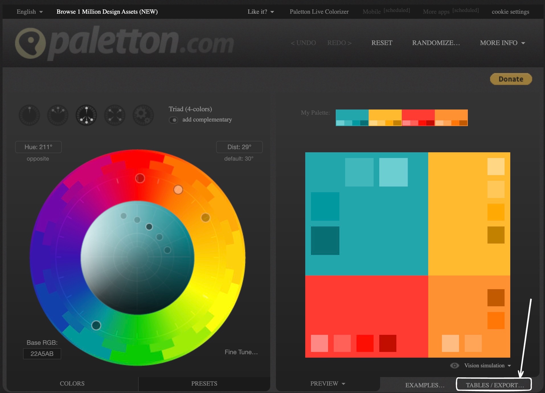

You can design your palette at http://paletton.com/
Once you are happy with the colors you need to export the palette.
The easiest option is to click Tables/Export in the bottom right of the screen - However, unfortunately, this feature often does not work :frowning: If you run into issues you’ll find alternative approaches further below

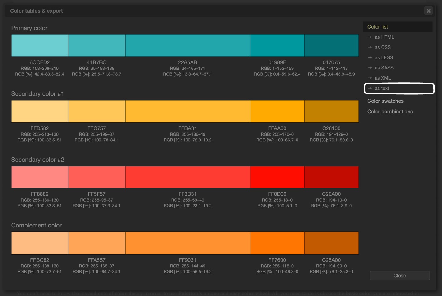

  1. Click the “Tables/Export” button as shown on the screenshot above.
  2. On the next screen click “as text”. You will need to manually delete “#” from the exported values, and format the file to match the example above, but it only takes a minute.

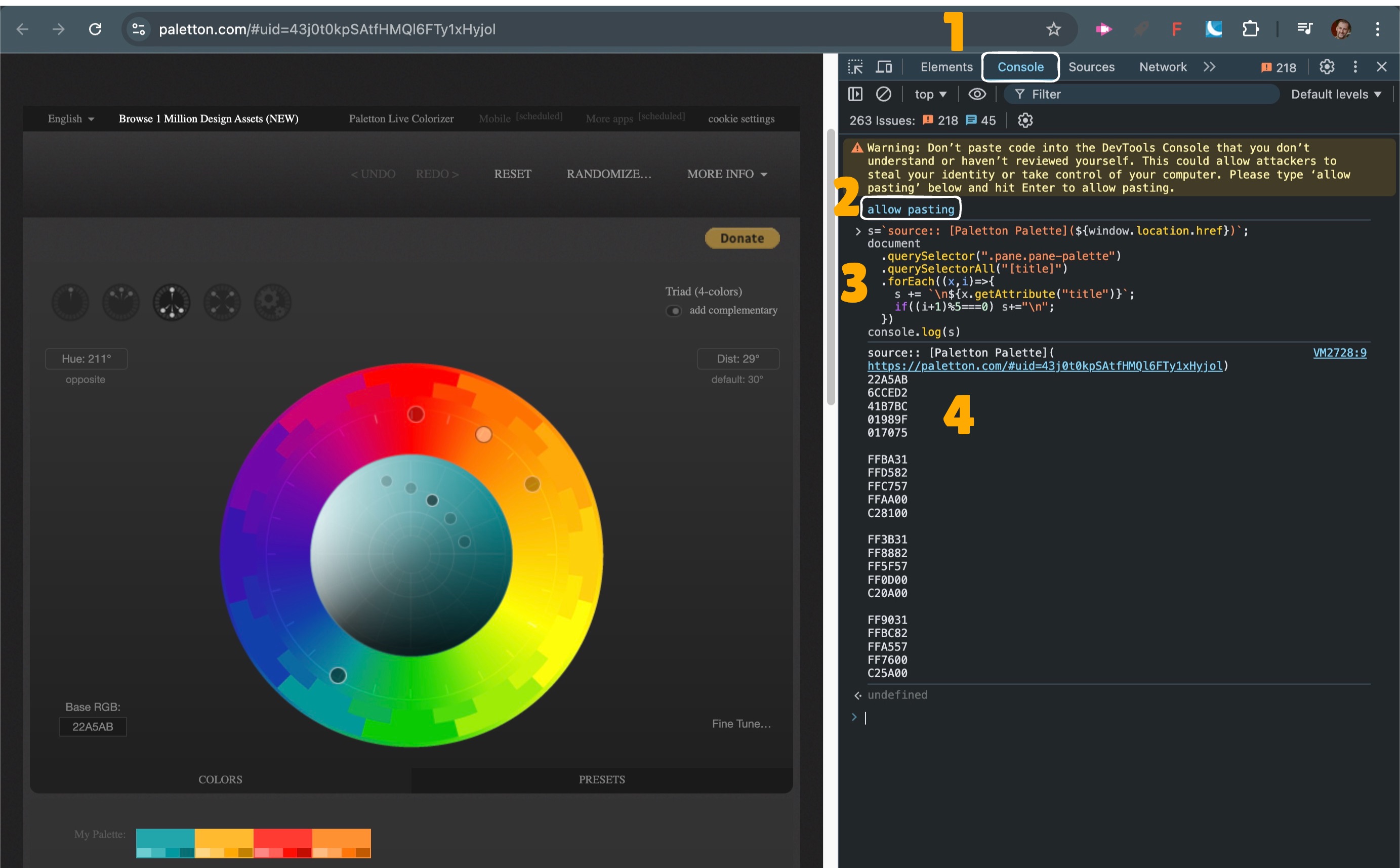

Option 2 - Use script to extract the values
If you are comfortable with scripting you can follow the below approach. However, note, that sometimes the structure of the Paletton page changes, in this case you may need to tweak the code a bit.
  1. On the palette configuration page press CTRL+SHIFT+i or (CMD+OPT+i on a Mac).
  2. Click “Console”
  3. Paste the below script. Note, if you have not pasted script to console before you will be prompted with a warning. You need to type: “allow pasting”.
  4. Paste the code and run it. If you run into an error, then Paletton has likely changed something. You can try to figure out the change using the Elements browser. At this point your on your own. You are probably better off manually copying the values to a text file as per the previous point.
  5. Select the result, copy it to the clipboard and paste it to your palette file in Obsidian.
Here’s the script you want to run:
